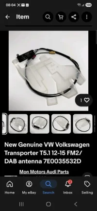

Doors you replace the plastic antenna sheet in the mirror?
This is an example of what they look like.
Thanks for the details @Dellmassive. Apologies but I should have mentioned that I didn’t do the replacement; it was an insurance job, so not really sure what they did/didn’t do. Likely they would have replaced everything, as they had to get a whole new unit. We don’t have DAB at all here, but I will take a look at the connections to check they are all as they should be. Thanks again!
