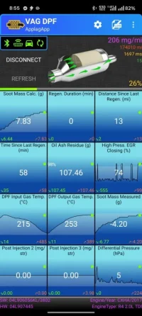

Great thread. I've had a crack at this now.
Out of interest what readings for differential pressure are people getting for idle and what peak number are they getting when they drive hard??
Would be really interested in this please as always thought my peak pressure was to high but may well be fine.

Care to share your numbers?
Preferably sensor raw value on idle for both cold and hot exhaust. Exhaust temperature sensor readings would be useful too as the pressure is a function of temperature as well as EGR position. Also would be useful be to know soot levels or distance since last DPF as it has a significant impact. Also emission remaps affect the readings - for the worse. Vehicle mileage also alters the readings as well as ash level.
I'm the middle of something so will reply with more detail later. Engine /turbo has only done 14k so disregard the milaege! I haven't/can't reset the ash levels. I was guessing I may have had a drop in the pressure at wot, seems ok at idle

Thought I'd keep the van and use daily forever more, however wanted to make sure the DPF is sound. I thought the differential pressure under full load was always quite high (mid-high 200's hPa (or Mbar as same)). It doesn't throw codes and drives/regens nicely but higher than BMWs I've had before - maybe just a VAG thing?? - hence my question to see what everyone's getting for the differential pressure reading??? - I would be really appreciative of any readings people could post after a wide open throttle (WOT) drive.

Any more comparable readings people could give me would be really appreciated
