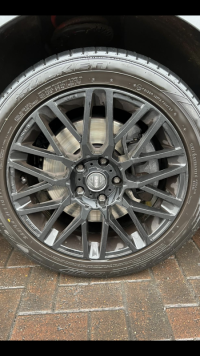

T6 T32 205bhp brakes, such a shame they let the Penny pinchers at the brakes on the T6.1 high power units. Sad state really.
Loving the bucket!!
Are they the discs that @jaymac had?
Rotinger?
£142 for the pair of 340mm’s
Looking to fit the same discs to mine when pennies allow!!
That’s the ones @moomin-j . Absolute stunning. Got a rollicking the other day whenI planted my foot to test them, SWMBO nearly head butted the windscreen. :oops::oops:
