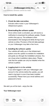

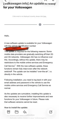

I haven’t had the fault looked at yet only had it a few weeks. 21 reg btw. It may or may not be the reason?.I've not had the fault and received the email.
