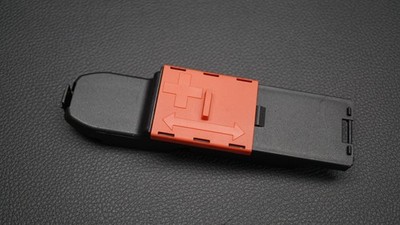

Well, opening that in where you might be might come up with different results than here :D. Basically I was more lost after opening that. Figured out after a couple of good headbutts to the wall its circuitry for diode. And quick YouTube adventure later figured out its purpose and uses. Could this be just installed on one of the incoming wires and turn it until works the right way around? Could that pop up some fault codes? Sizing? 12V / ?A.
Might also consider rerouting the washer line to the tow hook to spray on tailgaters :slow rofl:
You could connect a diode(example below) in series on your washer pump power supply line.
But as your BCM output is going to be activated( for the rear window) and diode won't allow (expected current to flow)
the BCM will register a fault in its memory.
To avoid that fault additional components are required.
Second diode in series with power resistor
connected in parallel to the power supply line before the first diode.
Also before any modifications, washer pump reverse current needs to be measured.
This current value will be required to calculate the resistance (Ω) of power resistor.
Judging by the size of the washer pump(as per below)
I would expect it to consume maximum of couple of amps(2A - 5A?) in either direction.
Finally diode will have tiny voltage drop(1V) when front washers are used
and therefore washer pump will operate at only 90% of its original speed.
But I don't think that anybody could notice the difference.
