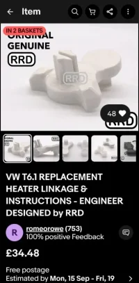

Do you have the link to the part. I’ve got a t6.1 with the issue

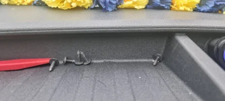

  • After ordering a 5.5mm spanner – it was too small. Both bolts on mine were 6mm!
  • As most know - first bolt was easy, second (concealed) bolt was very awkward. Best to use a standard 6mm spanner (shown below) –
  • Since:
  • 6mm socket set was too deep – not enough room for handle (I know some cut down the socket. I tried – was still too big.
  • 6mm “Ratchet spanner” failed - head was too wide since bolt was too close to edge = see example photo:
As such, I would advise using a non-racket spanner on the hidden fastening.
Removing access to the hidden fixing was VERY trick. If you have a 2020 T6.1 removing some of the dash helps see the hidden bolt.
Note – I actually did not remove the unit fully (didn't fancy trying to get hidden bolt back in) - so I kept the hidden bolt attached (I just loosened it to give 3-4mm of play. Then with the actuator was free to move and spin on the hidden bolt.
I also removed the stereo so I has access to the back of the actuator - removed the broken plastic clip and also removed the black arm. I then fitted the black arm to the new t.61 white clip (ebay). I then placed the white clip in position (not in the actuator - but the back rests on a raised stud – rotated the actuator back onto position, aligned the white clip and snapped it into place. Once there, re-screwed unit in place.

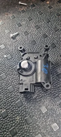

Removed my broken one this morning. Major faff 😬
It only had 2 screws holding it in place, should it have 3? Possibly broken for previous owner?
Now to source the parts.

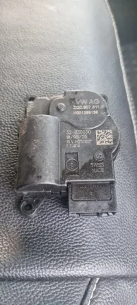

Made in Switzerland? It's certainly not up to Breitling quality.
Only has 2 screws mate. The replacement part is available from TPS and is different to the t6. It’s only about £30
This one? Is the oem part from TPS as weak as the original one which has broken?
If it helps anyone, I replaired my T6.1 without taking the dash out. I used a magneto spanner I had and a strip of metal with the spanner a light friction fit to get to the awkward screw. When fitting the new one, I cut a thin piece of plastic to push over the screw to keep it captive. I then used a long screwdriver wedged as shown to position the actuator and give access. The spare I bought from TPS was the modified part , I think the survo tries to drive past the end stop and over time flexing causes failure, I am not convinced the modded part won't cause something harder to get to to break so I don't use max hot or cold anymore. Cheers, Rob

I've just got round to doing mine, removed the motor and broken lever, does anyone know how far the motor should rotate from hot to cold?
