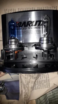

So, missing any legal H15 LED bulb, for the moment I have installed those regular halogens from Maruta... Here you can compare them with the originals , the Maruta is on the left of course.
Their galss is blue (you can see it clearly also staying in front of the van), the light that comes out is whit-ish, but still yellower than my dipped LED H7 (Osram LED Speed). Also they are not very powerful, sure less than the originally installed H15s (again regular Osrams). I do not mind that beacuse very rarely I use the main beams, and I like the color of the DRLs. In practice, since in my setup the dipped beam stay ON when clicking the high beams ON, you barely notice the latter.

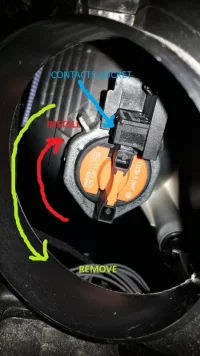

But the installtion was very easy, on my run f the mill Transporter T6.1.
Just remove the rubber covers, unscrew the old T15, and screw in the new one. Nothing else.
I want also here to confute some mithes that you need superpowers to change an H15 or that you must make strange maneuvers like removing and reinstalling the socket with the cables.
None of that. You need just to hold firmly the big rib that is on the lamp bottom firmly between your thumb and index fingers, PRESS forward (in the direction of norma car travel), then keep pressing and ROTATE - CounterClockWise for removal, ClockWise for installation. Like any normal rigth-handed screw, very natural. This is valid for BOTH lamps, left and right.
When you install the new bulb, keep the contacts approxmately at hour 10 position, insert the bulb, you must PRESS forward even more, until the 3 lamp contacts engage sideways the socket, and ONLY then , rotate. They will go in like a sharm. See the picture below, I hope it explains all.
In case you experience troubles matching the bulb contacts with the light's socket, smearing a little on oily "contact cleaner spray" on them (before installing it) should help. Do not use the dry type, it won't help. It wasn't necessary in my case anyway.
Do not forget to reinstall the rubber cover when you are done. I have attached here also a picture of the empty light inside, after removing the bulb. You may be able to see 3 small bulges around the hole. There is where the 3 small springs present on the bulb socket go against, so you have to press forward to go over them and lock the bulb in postion, while rotating.
