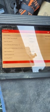

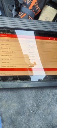

Hi all,
I'm wiring foglights to a 2020 t6.1. I have fitted the lights and fitted the wires to pins, 3&40 on the bcm. I have gone into adaptations and I'm not sure what to do now. Any help would be greatly appreciated.
I fitted a new switch with a front foglight position.

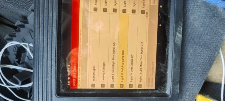

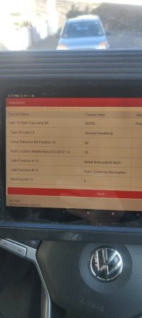

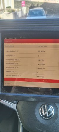

Quick update,
Pin 9 on the light controller has a cable installed.
With my current settings the foglight turns on when I turn the wheel. Still can't get the lights to turn on or the foglight on illuminated on the display
