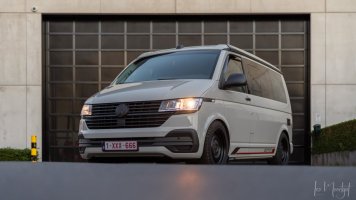

hmmm topped out the rears? as it looks to me it's more the way around. nevertheless i've got a cali t6.1 with kw coilovers.
dropped it the first time, she was heavy on the arse, so we lifted the back again, now she's nose down.
than i changed the wheels to 18inch banded amarok steels with general grabber at3 235/55/18
i noticed the front was rubbing a bit on full lock and when taking speed bumps, so raised the front a wee bit and now she's running sweet
meanwhile switched the banded steels for some 18inch alloys, with some spacers,
i like the looks and i can still get to some mild remote places ;-)
