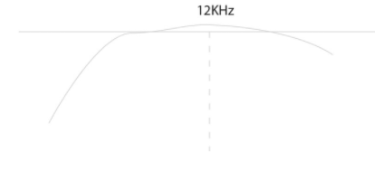

Thank you for your patience and sorry for the delay in replying to you. I have installed a set of these speakers into our demo van and I have also spoken to the sound engineer in Germany involved in the assessment of the speakers.
He has shared the RTA (sound curve) of the tweeters with me, they have a natural peak at around 12khz. This is quite normal for speakers to have various peaks, no speaker will have a perfect flat sound response. Outside of this peak at 12khz the rest of the freq response is good from the tweeter. The graph below is taken from the RTA of the tweeters.
Also we all have different acoustic requirements in a sound and add to that all of our hearing is different. Some like a high treble where others, me and by the sounds of it yourself too don’t like high treble.
The best way to deal to reduce this peak is by using the treble adjustment on the radio, this is an EQ and it helps to just reduce the peak frequency, this being 12khz in this case. If you using a general gain reduction such as a -3db reducer on the tweeter then it will affect all of the tweeter sound frequency range, it will not reduce just this peak at 12khz, in fact you will still have the peak compared to the rest of the freq range, it will just be lower volume output from the tweeter.
