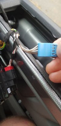

T6.1 doesn't seem to use resistors like T6 so you should be able to wire in a secondary lock/unlock SPDT momentary rocker switch (or 2x mom buttons) off the connector for the drivers door lock switch.Following on from this. Has anyone figured out how to install a 'Lock' (and 'Unlock) button in the rear of the T6.1?

Interesting, thanks for that, it raises the following questions;T6.1 doesn't seem to use resistors like T6 so you should be able to wire in a secondary lock/unlock SPDT momentary rocker switch (or 2x mom buttons) off the connector for the drivers door lock switch.
I tested this by bridging the connector manually with a staple.
Lock:
Unlock:
Page 4: https://www.t6forum.com/downloads/convenience-systems-wiring-diagram.145/downloadInteresting, thanks for that, it raises the following questions;
Is the common pin 0V, 12V or something else?
Can the lock/unlock wires be accessed under the dash for connecting a second set of buttons?
What are the wire colours/stripes ? (looks like 3 whites and a brown here)?
This shows only one button, and two lights, I thought your staple simulated two buttons?Page 4: https://www.t6forum.com/downloads/convenience-systems-wiring-diagram.145/download
Ordering below doesn't correspond with connector pin ordering):
+12V, GND, Signal, Signal
Yeah it's a bit weird how they drew the diagram as it should be a rocker.This shows only one button, and two lights, I thought your staple simulated two buttons?
What I've found today is;Yeah it's a bit weird how they drew the diagram as it should be a rocker.
I think it's because PIN4 / SIG is either grounded for lock or +12V for unlock.
