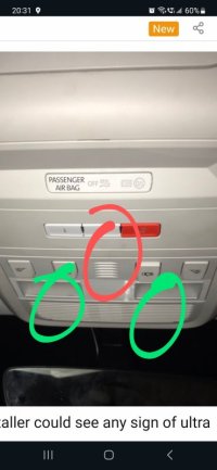

what alarm was factory fit? - have you got the ultrasonic fitted in the top centre console on the roof? - post a few pics.

I nor the installer could see any sign of ultra sonics.
I also cannot find the 'interior alarm disable' button mentioned in the manual.
There is a red LED that blinks on the drivers door console, when the vehicle is locked... Even just locked manually with the key in the door.
Thanks for your help.
Normally the red is the phone MIC.
And the green is the untrasonics.
Take a pic looking into the grill area in the green.

Sorry about the last shot, bit dark out there last night.
Where should the interior alarm disable be?
On the driver's b pillar about 2/3 of the way down
