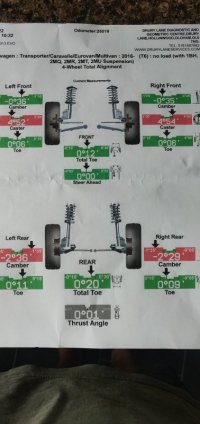

Heres my hunter report.
I've had the tracking done in the past and i dont think it was done right,the wheel was off centre. So i had it put straight which i now think is why its off centre now.
