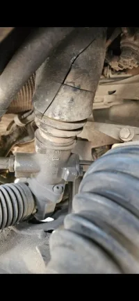

My T32 van has recently developed an issue with the steering with the following issues -
- lumpy steering with inconsistent resistance. Stiff at some points of the lock but loose at others.
- rubbing/rumbling noise when steering coming from directly below the steering wheel (not top mount area)
I've had it up on a ramp and can hear a rumbly noise from where the steering column goes into the steering rack when steering.
The boot that protects the bottom of the steering column has been split for a while (photo attached), so my question is what is the most likely cause of the above issues? Is it likely to be the universal joint?
If it is the rack, does anyone have any advice on removal?

Does it have a part number on it? Most likely easiest to get one from your VW dealer to ensure correct part.
Definately just go to VW for that boot. That's what I'll be doing tomorrow.
