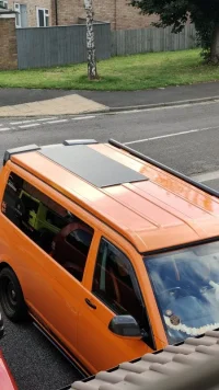

I changed my 100W PV Logic panel out for a new 200W Photonic Universe one recently.
Different orientation on the roof but used the same hole already drilled through the roof panel. I replaced the vinyl beneath the panel ( see the thread Roof wrap for solar panel for more on that) and stuck it on with Sikaflex 252, I added some 10mm slices of plastic pipe about every 15cm sandwiched between the vinyl and the panel in the valleys to add some support spacers in those bits as the panel would otherwise only be stuck on the centre spar and the very edges of the next two smaller ones to eliminate any sag that may occur. I have sealed the front edge with Sikaflex but left the rear end open for cooling.
@Grim Reaper amazing, thanks for that, I think you've got the same panel I bought and have yet to fit. I like the pipe idea, are they stuck so the opening ends of the pipe are pointing up and down? Also is the hole for the junction outside of the canvas?
Yes, I cut 10mm slices of some 30mm diameter plastic pipe that I had in the garage, drilled a couple of holes in each slice to ensure air pressure could equalise once they were stuck top and bottom and stuck them to the roof first, then piped some Sikaflex around the tops and along the spars and around the hole before lowering the panel on top of them and stacking a few bits of 2x4 and some bricks on top of the panel to hold it down while the Sikaflex set.
The hole goes through outside the canvas and the wire goes in through the velcro then a large loop to one side before going through to the inside of the van in the middle above the tailgate.
