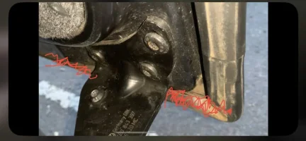

Hi All. A few weeks back I had the roller on the sliding door fail / disintegrate through corrosion. Although this was only a 5 year old van, it seemed a common problem. Through searching the forum I also discovered another common problem - sliding track channel water collection. This was something I’d increasingly noticed over the three years we’ve owned our van. Looking at where the water was coming from I then realised that the outer door bottom seal was not only blocking the door’s inner drainage holes and also trapping water draining around the door into the channel. Last week I took the bold [and hopefully not foolish ] measure of cutting the bottom section of this seal at the corners and removing the bottom section and f seal. This now seems to be allowing water to drain out effectively- exactly like the cab door arrangement where the seal is discontinuous at the bottom. Is this a widespread design flaw? t6 sliding door seal - Google Search.webp

Hi All. A few weeks back I had the roller on the sliding door fail / disintegrate through corrosion. Although this was only a 5 year old van, it seemed a common problem. Through searching the forum I also discovered another common problem - sliding track channel water collection. This was something I’d increasingly noticed over the three years we’ve owned our van. Looking at where the water was coming from I then realised that the outer door bottom seal was not only blocking the door’s inner drainage holes and also trapping water draining around the door into the channel. Last week I took the bold [and hopefully not foolish ] measure of cutting the bottom section of this seal at the corners and removing the bottom section and f seal. This now seems to be allowing water to drain out effectively- exactly like the cab door arrangement where the seal is discontinuous at the bottom. Is this a widespread design flaw? View attachment 197621
Hi, just noticed the same issue on my campervan. Any chance if you could post a photo of the "finished product" just to get a visual idea of your solution please. Have you completely removed the bottom seal? Many thanks in advance.
Hi Ed
Here’s some photos of where I cut and removed the rubber.
It’s interesting to see some similar posts elsewhere now.
Water will always get into doors eventually- that’s why all vehicles have the drainage holes. Even with buildings and their glass facades (curtain walling) these have drainage paths and holes for water to escape. But the thing with the t6 is the extra seal and rubber along the bottom is trapping the water from escaping. Take a look at the front doors and you’ll see - no rubber along the bottom.

Hi Ed
I have done the same now, but noticed that the water was still collecting as my van is parked on the side hence the rain water was jus collecting there. Now I am parking the other way and no water can collect. Rather bad design to be honest and wonder will there be a water ingress when going on a wet road, but as you have also noticed there is no bottom rubber seal on doors anyway.
