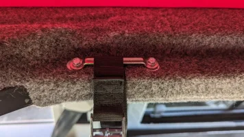

I have more information now. The part that bent was the cam itself. While most of it is very solid it bends where the actual cam lock fits through. There is a big square hole in the arm and that is the weak point.
The fix is very simple, a washer above it to spread the load and it should be fine.
