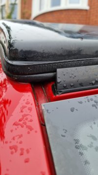

Another one to add to the list. Came up a few times on a recent trip.
Some things to note.
When it was happening I could pop off the roof from the cam with my hand fairly easily. Slightly more pressure than I normally use to check it but not much at all.
Popping the top fully and actively trying to push the roof back a bit whilst dropping it seemed to make it engage a bit better. I'm not sure if there is some play in the roof that makes it more likely. One side was fine one was not. It seemed to have more play in the cam on the one that was worse.
The channel for drainage seems to be a way for a fair bit of air to get in so as a temporary measure we taped up this gap and secured the handle inside.
Phoned skyline this morning and booked in for Friday morning to have the locks updated and all checked.
Nasty experience but hopefully sorted soon.
LWB T6 fitted by Skyline themselves originally in 2021.
This the the gap I mean.
