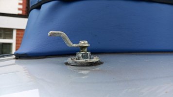

Difficult to get a good pic but this one failed. Could tell it was only catching at the very end of the lever part. On checking, the nut on top was loose. Not replaced with new (although same) cams and new bars in the top
Those look like the catches we used to fit to machine covers/guards. They were for light duty in a static application. I would say they aren’t fit for purpose on a heavy roof subject to aerodynamic forces & vibration.
The catches are from the Southco E3 range, they seem to use various types, we're now on our second after the original catches failed.
The manufacturers data sheet states a load rating of a load rating of 300N... So around 30kg.
I had a look at my mate’s Aurora yesterday, his lock tongue is twice the length of yours in this photo.
It fully engages through the keep with 10-20mm poking out of the other side.
