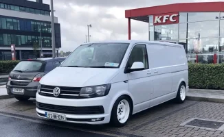

BF1CFA9A-3C0D-4F48-9857-CF5CDF08A749.webp I’d like to throw my two pence worth....
I’ve a T30 LWB that I’ve had for 8 months now.
When first getting it, the first negative I noticed (the list of positives were huge!) was the very soft suspension. Far softer than the 2002 Trafic I had before it. Going along in a straight line is lovely but come to a roundabout and my confidence dropped. So I had to look da adjust my driving. Although I always planned on lowering on coilovers (was thinking B14 at the time) this characteristic made me deffo decide.
While trying to work out how to pay for B14’s, Transporter HQ brought out So Low by Bilstein.
In a nutshell, B14 will lower 40 - 70mm, while the So Low will go from 80 - 130mm! I thought well if I’m gonna lower it, 40mm won’t be quite enough for me. I would probably go closer to the lowest at 70mm. But then realised there’d be less travel and probably stiffer ride etc.
So I got the So Low kit with the sole intention of haveing it at its highest setting. Do the coilover is working as easy as it can, etc.
I’ve just had it fitted last Friday. The ride is UNREAL!!
It’s important to note I think, that I also fitted 17” banded steels and I believe it would feel quite different if I was in 20” wheels.
Anyway, it’s amazing. The handeling is sooooooo much better, not harsh in anyway. Round our way we’ve a million speed ramps and there’s no bother with any of them.
Cost me a bloody fortune (if the missus knew, Christ!) but worth every penny/Euro.
