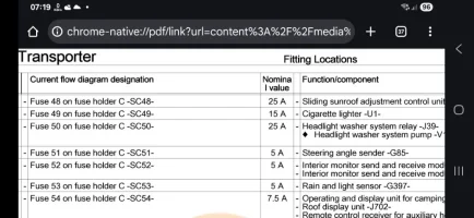

I get different listings for the fuse. Dash panel insert - control unit J285 and in an other diagram it’s down as the steering sensor.

The T6 list shows steering angle sensor.

The fuse (51) is given as "Dash Panel Insert K" on the most recent fuse box diagram I have, This seems right as pulling the fuse resets the clock in the centre screen. Is there a diagram showing what the Dash Panel insert loom serves?

Have you had a look at the fuse charts in the download section.
To see what's powered from that fuse?
SC51 solely feeds
Dash panel insert -KX2-♦ Control unit in dash panel insert -J285-

This might help isolating things, KL30a is supply from Battery, SC51 Fuse and KX2 with related connections.
Hope it helps.
