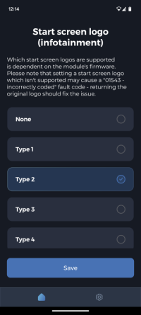

From memory the 01543 code is because you've changed the screen picture! Go back to the original screen background and it will go away!

Hi, do you know which option / type is the original?
Top of the list? The boring VW logo shines up in all its glory! Not as exciting as the GTi logo screen, but no Clarissa faults! Let me know if you can't find it I'll have a look later when I get back from work!
Thanks, I've tried none, 11 and 14 (all just say welcome to VW)..

Perhaps try 'type 1'....
