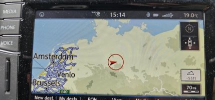

Hi guys
I had the infotainment system replaced a couple of week back under the all in warranty due to the failed touch screen issue but I've just gone to use the sat nav and it thinks I'm in northern Germany!! before i take it back to VW again... anything simple I'm missing?
ta

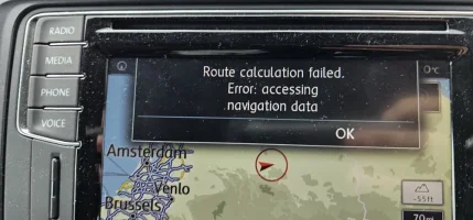

Yeah tried to put an address in but as it thinks its in Germany and the map doesn't cover Germany its not finding a route. Also tried the center location button but no joy. Thanks for your reply.

I wonder if they've plugged the GPS antenna into the back of the unit correctly. Have you tried resetting the unit with the long press of the power knob?
That's my thought and as it has to go back because they damaged the dashboard fitting the new radio I've told them to sort this as well. Yep tried resetting via the power nob. Thanks for your ideas.
