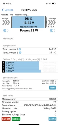

I am wondering if I am a bit thick, but can anyone enlighten me on what the On-Off "Charge and Discharge" toggle switches do on my gen 1 Roamer Seatbase battery?
They seem to disable the power displayed by the app, but this seems to have no physical effect on the function of the battery. What am I missing?
Let's ask @RoamerBatteries for more info.
I would assume that it blocks the incoming or outgoing current flow to the battery.
