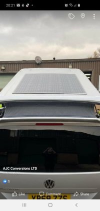

Wait until the panel fails and see what your roof looks like once you`ve managed to peel it offWhy are people putting these huge things on their roofs when there’s flexible solar panels …. They are so ugly

Hi , mine is a rigid solar panel, not a flexiWe fit alot of flexible solar panels, but we leave a 4-5mm air gap to allow heat to escape. This is definitely important !
The slim panel together with a underside junction box gives a very neat insulation. We have had customers tour Spain and similar hot countries in summer months with no issues.
If the worst does happen it can be removed in a similar way to a window removal and cut away from the body.
