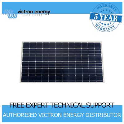

I was literally just looking at that!
Yes, feel the envy rise inside you, use it... :rofl::p
That's the panel I have FYI. With a 100/20 MPPT i regularly see 250w or more even at this time of year. I'm overpannelled so will only see a max of 280w or so. 150w at 10am today!
Great Paul, I'm going to go with the Victron 270 watt one (I love the blue stuff), should be happy running 2x 4amp fridges and all the varied power suckers we like to use! I have a 100/20 installed already.
Like @The Flying Scotsman I'll be bolting down the front 2 feet through the lid, and possibly the middle ones too? Shouldn't be too tough to do...! I really don't want that ugly gland on the back though, hopefully hide it under the panel somehow...
Determined to not be in the 'big Boys club'! 270 is considribbly bigger than my failed 180 flexi, Victron, 5 year warranty, can't be bad.
With a decent bit of sun I with 270/280w and 230Ah I reckon even with an hour of inverter use a day, I could go for an unlimited account of time.
