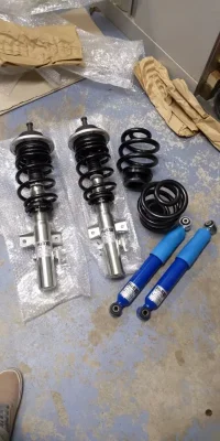

T6 euro 5 204 manual
T30
Front height = 360mm
Rear height = 370mm
Springs & Dampers = Bilstein B14
Wheel size = 18" Edition
Tyre size = 255/45/R18 Y 103
Tyre Manufacturer = Continental sport contact 5
Normal load = Tools and kit
Comfort = Nice, firm without being harsh.
ARB's = standard VW.
feels perfect,only problem with b14’s is they compress with too much weight, managed to snap rear spring, so replaced and raised 5mm
must say better than Vw lowered springs had on previous van
T30
Rear height = 370mm
D242EA1F-5F76-4063-A2E0-490386AE67C3.webpD242EA1F-5F76-4063-A2E0-490386AE67C3.webpD242EA1F-5F76-4063-A2E0-490386AE67C3.webp
