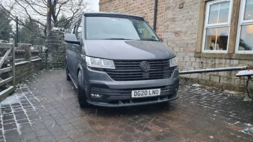

When I purchased my van I was hoping the handling would be similar to that of an SUV or MPV Sadly it was not near what I wanted - the light front end, vague steering and excessive body roll front to rear under braking and side to side on corners had me gripping the armrest of my driver's seat on any roundabout.

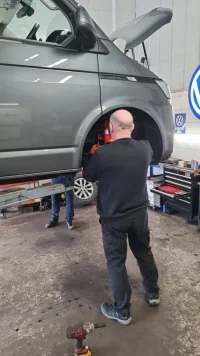

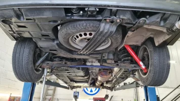

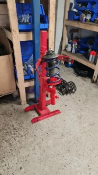

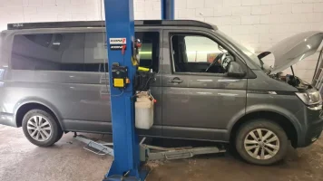

Reading the posts on the forum about wheels and suspension the name of Steve @CRS Performance kept appearing with nothing but positive reviews so I call Steve to discuss my needs. What a guy! He was so helpful and knowledgeable he lived up to his reputation of giving honest and impartial advice. He explained the reason for my van's poor handling as it was sitting 40mm lower at the rear due to the weight of the conversion and pop top. He advised fitting Koni Active dampers all round, H&R anti-roll bars front and rear, and H&R 40 mm lowering springs on the front only, leaving the standard springs on the rear as it was already 40mm lower.

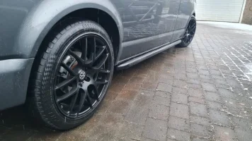

He had and fitting slot available the following Saturday. I had purchased set of wheels from another T6 Forum member (TSixty) in Nuneaton so set off on Saturday 18th February, I collected the wheels was reassured by TSixty I was in safe hands with Steve, then headed to @CRSPerformance in Cannock. Steve and his son had a whole lot fitted in just under 1 hour. They also fitted side bars and a splitter I purchased from Veedubs transporters for a modest labour fee. The drive back from Cannock to my home in the Northwest on the standard wheels but with Steve having worked his magic on the suspension was an absolute joy! The handling had improved immeasurably body roll was vastly reduced and the suppleness of the the Koni dampers meant I didn't have to spend my time dodging the potholes or cats eyes. The van's handling feels closer to a car now. I fitted new tyres and new wheels at my local tyre fitter and the ride is still just as good on the bigger rims and looks better. I just wanted to let those of you who had the patience to read to the end of this post that if any of you need advice and installation on suspension please speak to Steve @CRS you will not regret it. I have waited a month since Steve worked his magic on my van as I wanted to live with it and get beyond the honeymoon period of buying new stuff. To see if I still feel the same way. All I can say is the honeymoon has not ended, I'm still grinning like an idiot every time I drive a van thanks to the vast improvement in its handling. Thanks to Steve @CRS Performance and thanks to all of those of you who contribute to the T6 Forum giving your time and advice to freely, to a newbie like me.
As I know you all like pics I have attached few.
