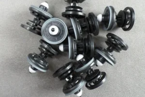

Does anyone know how to get the interior trim off that covers this unit? I think one of the control arms on mine has gone faulty so want to get inside to have a look. I have tugged at it and tried with a trim tool but it seems pretty secure. I don’t want to damage it, but do I just need to pull harder at it?
I used brute force on mine but broke some of the clips - if removing again I’d get one of these and try and release the clips from the top edge working down.
Am-Tech Trim Clip Removal Pliers | Euro Car Parts
The clips have an open and closed position and they need a ‘wedge’ inserted to get to the open position. Once the panel was off I used two trim tools to reset the clips (the tool above will do it!). These are the clips:-
Great, thanks for that. They are the same trim panel clips as the front door cards, now I know what’s behind there a good sharp tug should do it. I might order some spare clips anyway....
