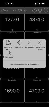

The Torque app thingy is actually very simple thing to run - the first blurry posts are just how to set it up. Then the Torque does all the required data recording behind the scenes.I’ve been through that topic a few times but it’s way over my head!!
Unfortunately the Torque setup is Android only.I’ve got an iPhone only unfortunately
I’ll download the car scanner app tomorrow and see whether I can make sense of it.You mean the countdown from 650 miles - I think there are two separate issues - at least the ECU sees them as two separate issues.
Also VCDS would do the same (and much more).
In iPhone world the same could be done by using "Car Scanner" app - all the proposed data values should be available right away by selecting correct vehicle connection profile.
Yes, of course - see the link below for details and some useful hints how to use.Would it log the data you mentioned earlier so it can be looked at afterwards?
