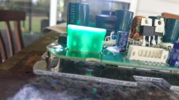

My ongoing saga with the alternator not kicking in has been resolved. I had seen too many images of the internal 30amp fuses blown with clear burn / scorch damage, so when I finally managed to get my d250se out and look inside I gave it a clear bill of health based soley on the absence of burning / scorching. . Bad mistake and not the first time I've given myself ball ache by not checking fuses properly.
Following a lead from another forum a blown fuse was there.....
The image above isn't my unit. The body of the fuse is easy to clip and slice away leaving the two legs in-situ which can accept spade connectors, so a short flying lead with a new fuse on one end and spade connectors on the other means a non-soldering fuse replacement can be made.
Top left you can see the now exposed fuse legs. My alternator now kicks in fine.
However the unit still doesn't want the charge my battery beyond 85%. If anyone knows a possible explanation for this please let me know.
I've also replaced the 30amp midi-fuse from (and at) the starter battery with a 25amp one, hopefully that will blow before the fuse inside the unit, and being easy to replace it seems a no brainer.
