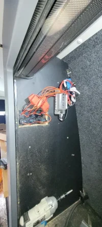

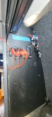

I need to discuss fuses.
80A battery to busbar via 35mm2
60A Renogy DCC50S to busbar via 16mm2
60A from busbar to fuse board via 16mm2 to a 15A
30A at busbar fed by cable from 20A ANL inline fuse fed from AC charger (20A charger for battery)
I think that looks ok. If you do decide to connect your inverter then you’ll have to increase the fuse on the 35mm2 to the bus bar.
Looking good that everything works.
Is the dc-dc working? Did you connect the run detection cables?
IGN connection will be tomorrow. I ran a black wire to neg bus bar so just got the piggy back to put in. Need to figure out my multimeter...
