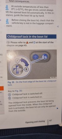

Hi all,
I have a powered opening tailgate with the button on the tailgate door to close it.
This works, but not when the boot is closed.
The manual says there is a child lock for the boot that disables it...
But I cant find this anywhere! Any ideas?
Matt
I don’t think you get both, a standard tailgate has the child lock button where your elec button is

Pretty sure the childlock switch on mine is on the bottom of the tailgate, can only be accessed with it open

Yeah, checked there. Sounds like the leccy one doesn't have it.

Tailgate bottom edge switch is deactivated while tailgate is closed.
This switch can only be operated when tailgate is opened (partially or fully).
