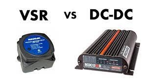

Split Charge Relay vs DCDC charger.jpgLook around the van for one of either of these devices, you really want something the size of the one on the right, not the one on the left.

View attachment 225073Look around the van for one of either of these devices, you really want something the size of the one on the right, not the one on the left.
Looking at one of the pics that looks like one of the all in one CBE PDU modules so it might be neither, it might just be a relay in that.
I doubt it's a gel battery, those are usually quite low capacity UPS type batteries, if it's a basic split charge then it's more likely to be AGM same as the starter.
