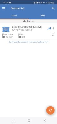

Here is what it keeps stating no matter what. Granted the drive I did was 15mins or so but again, just stayed at 12.32V.

If the value is not changing at all that's very strange, generally a failing battery looses capacity so you'd still see a healthy voltage when the alternator is running, it would just drop away much quicker than normal when it wasn't.
So either the Victron is seeing a very stable voltage from somewhere else or possibly it's just locked up. If you know where the supply fuse to it from the starter battery is you could try removing that for a bit and then replacing it to restart it.
