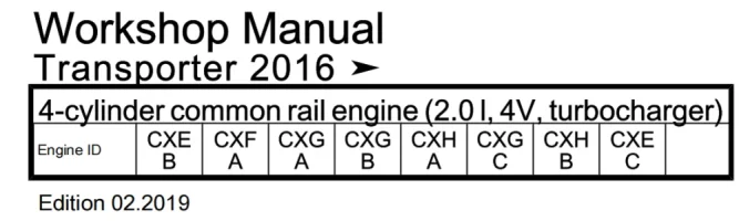

Google actually isn’t my friend because the answer for definitive torque figures for VW Transporter engines vary widely to the extent that it would be taking pot luck which I don’t do. My ADHD makes me need to know the exact tightness. I’ve been servicing cars for over 40 years and won’t guess any torque setting.

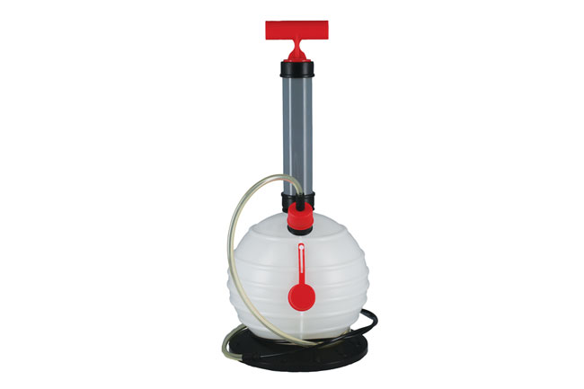

Well worth buying a cheap Amazon vacuum pump (re-work the obvious when it falls apart) and withdraw approx’ 5L and then drop the rest.
I use a Lazer 6ltr oil extractor, I removed the oil in two stages, emptied it after 4ltrs had be extracted and removed the the remaining oil. I then removed the sump plug to empty any residue oil. Note when removing the oil filter housing there is a central plastic bolt which drains the filter bowl before you unscrew it to gain access to the oil filter.
