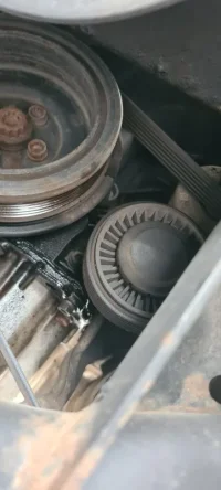

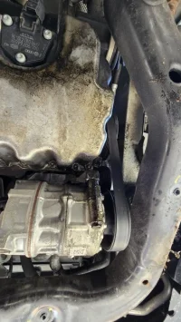

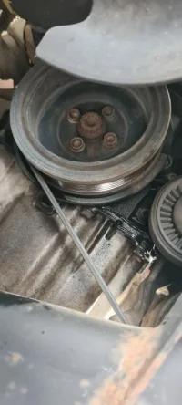

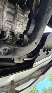

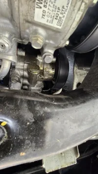

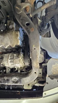

Hi,
Has anyone any idea where this leak might be from? Just dome 4k through France and Spain and it definitely wasn't there before. Only a small amount of oil has been lost.
Thanks
Same for me Oil leaking, any ideas, suggestions. 35k on the clock. I recently did a trip around Europe about 4k. There was no leak before the trip.1000022960.webp1000022959.webp1000022958.webp1000022957.webp
Crankshaft front main seal. . . (most likely, a common thing on a T6)
to be sure, take loads of pics.
then clean its all off.
then drive for a while and keep checking - you will then see where its coming from.
