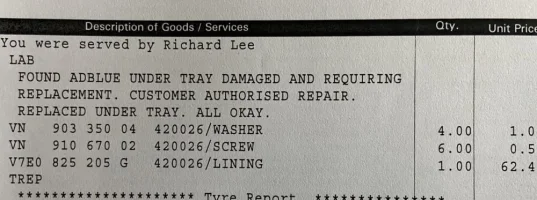

I had the same problem with mine, despite searching for Ad Blue Under tray I could confidently find the number (I didn’t find this tread then). Part number V7E0 825 205 G for £62, but £140 fitted so worth being able to source yourself if you can access underside of your van
7E0 825 205 G is the part I bought. Differed from the original in that it had a heat shield fitted to it. Easy DIY fix once you’ve got the van up on the ramps.
