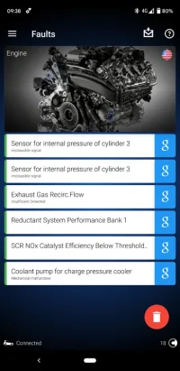

You really need to see the details of the faults to see which one is bringing on the MiL light.Yeah this is what came up today when i checked. I have cleared all the codes on the past and they reappear a few weeks later.

Make sure your EGR flexi pipes (front and rear) aren’t leaking. This is detected as a low flow, which means the EGR doesn’t reduce the NOx as much, and the AdBlue has to work harder. It gives up at a point and flags an error.Hi guys,
I have this recurrent issue. The van drives perfectly but I have got the engine management light coming up on my dash after few hundred kilometers (distance varies, light usually came up on motorway) it is always the same error - the top one, and sometimes others. They tried updating software, and now they cleaned the system and changed the glow plug1 I believe. The error has returned. This time it disappeared for some time and then returned after downing the fuel almost to empty (motorway mile s only, the EML light came up after starting the engine few days later but before refueling). It is unfortunately out of manufacturers warranty now.

How can I detect the leakage?Make sure your EGR flexi pipes (front and rear) aren’t leaking. This is detected as a low flow, which means the EGR doesn’t reduce the NOx as much, and the AdBlue has to work harder. It gives up at a point and flags an error.
