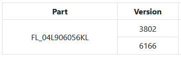

Your scan....
Address 01
Component 3802
Component should be 6166 now.....
VW now apparently charge for the upgrade but you might be able to blag it
Reactions: mmi
Part No SW: 04L 906 056 KL HW: 04L 907 445
Component: R4 2.0l TDI H02 3802
Your current software is 04L 906 056 KL version 3802

First incident 220 miles ago and has occurred twice since then (frequency 3).
MIL came on after about an hour and a half.
Based on my observations that was fairly typical pattern with old software - long duration journey where a DPF regen happened.
Some related measurements below - massive NOx emissions during DPF regen
