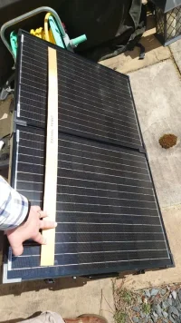

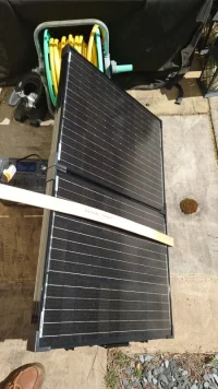

So next I grabbed a batten of wood to simulate shade from a roof bar or similar
Does not look like much does it, you might guess 5-10% loss?
But look what happens in reality - it's right down to 21w so the panel is at 1/5th of its power!
How bad it is depends on the orientation of the cells and the shading, in this case the impact was high as the shade was across all the strings of cells.
So if the shading was the other way the impact is still there but more what you expect as it was shading one complete string on one panel but the others were fine, as was the whole second panel.
Does not look like much does it, you might guess 5-10%?
But look what happens in reality - bang right down to 21w so the panel is at 1/5th of its power!

So if you look at one side of my panel you can see there are 3 columns of cells arranged in a zig zag fashion up and down, with the fine bus bars in parallel to pick up the charge well across the cell.
If you count there are 36 in series so rule of thumb this is an 18v panel, that ties in pretty well with the document optimal working voltage of around 20.
Knowing the layout of your cells is not just a nerdy thing, it can help you understand the best way to place your panels to minimise shading.
As demonstrated above if the shading is across complete cells then those cells not only stop generating but also become a high resistance, stopping the other cells in the same series chain. This is why there is such a dramatic drop with the bar across.
However the bar up and down only partially shades the cells in one area meaning the current from those drops but they don't become high resistance so the impact is just the current drops to that of the shaded cells.
This is why shading has serious impact, it turns shaded cells into resistors that actively stops the unshaded cells from generating.
