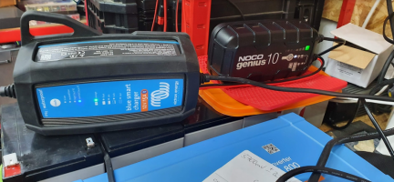

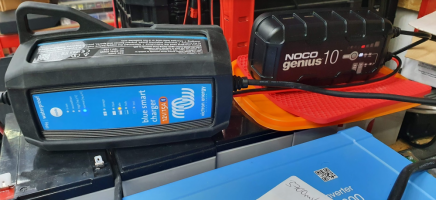

this is the charger.

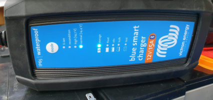

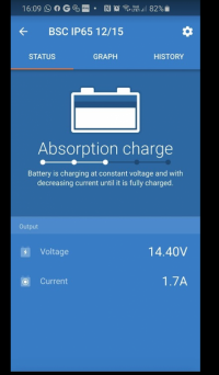

this is the charger readout . .

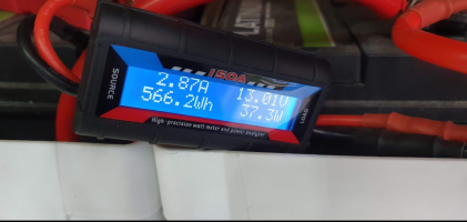

and this is the BM2 readout now have moved over to the second battery. . .

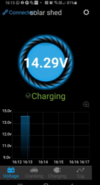

charger is in float mode . .
BM2 shows voltage leaved out for Float . .

The NOCO is a 10A smart charger - The Victron is a 15A smart charger.
The Victron can be programmed via the APP to tweek the charge profiles. - The NOCO can-not.

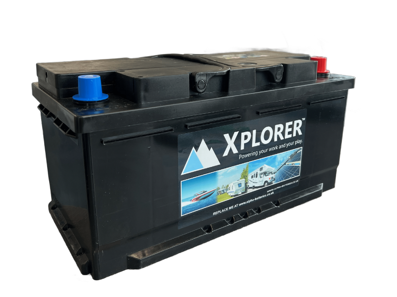

isnt that an AGM battery? . . .
is so then the second "AGM" profile would be better suited ( slightly higher charge voltage )
edit:
just checked - no its a standard lead acid. ( SLA )
so that's the correct profile . .
12V 110L Low height Xplorer dual-purpose flooded lead-acid battery for multipurpose leisure use
Features
• Low-height (suitable for installation in applications with limited battery box height, eg. campervans and motorhomes)
• Wet Flooded technology (tried & tested)
• Power demand level of intended application: Low – Medium (occasional, light, casual usage)
Flooded serviceable batteries are the traditional, wet-cell, lead-acid choice; the technology has been used in a wide variety of applications for decades.
Yeah its a standard SLA

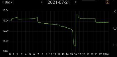

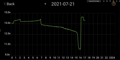

update. . .
its the following morning...
The Victron has gone through Bulk, absorb, Float . . . and is now in storage mode.
it delivering around 3.5A to the battery, which is now effectivly running the load - (Pump)

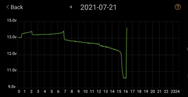

the BM2 plot shows a marked difference from the NOCO.
1600hrs charger connected. - Bulk (14.2v)
1645hrs charger into absorb (13.6v)
1715hrs charge into float (13.2v)
2100hrs charger into storage + supplying the loads (13.0v)
tbc,

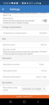

i noticed in one of the replies @Dellmassive you state you can adjust the charging profiles on the victron, is that easy to do or for my sla is it not worth it and just plug & play.
thanks
All looks very promising for the victron unit then. I best get the credit card out lol
thanks
They plug and play.
Very easy to control via the APP.

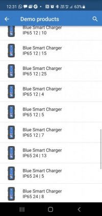

Download "victron conect" from your App store... they have demo files you can play with.

All the chargers are listed on the APP....
Free demo files to play with...
Screenshot_20210722-123246.jpgScreenshot_20210722-123210.jpgScreenshot_20210722-123157.jpgScreenshot_20210722-123148.jpgScreenshot_20210722-123140.jpgScreenshot_20210722-123126.jpgScreenshot_20210722-123133.jpg

ok. . . . its the end of another day at work and time to check-in on the charger. . .
its still in storage mode . .
its still delivering around 3A that is running the load (pump)
and the voltage has been constant . . . not cycling like the NOCO was doing.
it seems that the Victron will run run like this for ever . . ?
so its time to upset the flow. . . at what point will it restart its cycle?
well lets see.
i decided to add some more load. . . i plugged in a dehumidifier in (on fan only mode).
this took the load up to 7.5A - half the rated 15A of the charger . .
but the charger sat there very happy . . . still in storage mode . . .
so now i threw the big guns at it . . . i switched on the compressor side of the dehumidifier on.. .
The inverter started beeping the overload warning . . . the compressor spooled up.
we were now pulling the full 15A from the charger . . .
which now caused the battery voltage to drop slightly due to the current flow . . down to around 11.9v under load.
at this point the charger moved over to bulk mode and started a new charge cycle . . . . back to 14.6v bulk charge.
you can see the change here . . .
and here:
