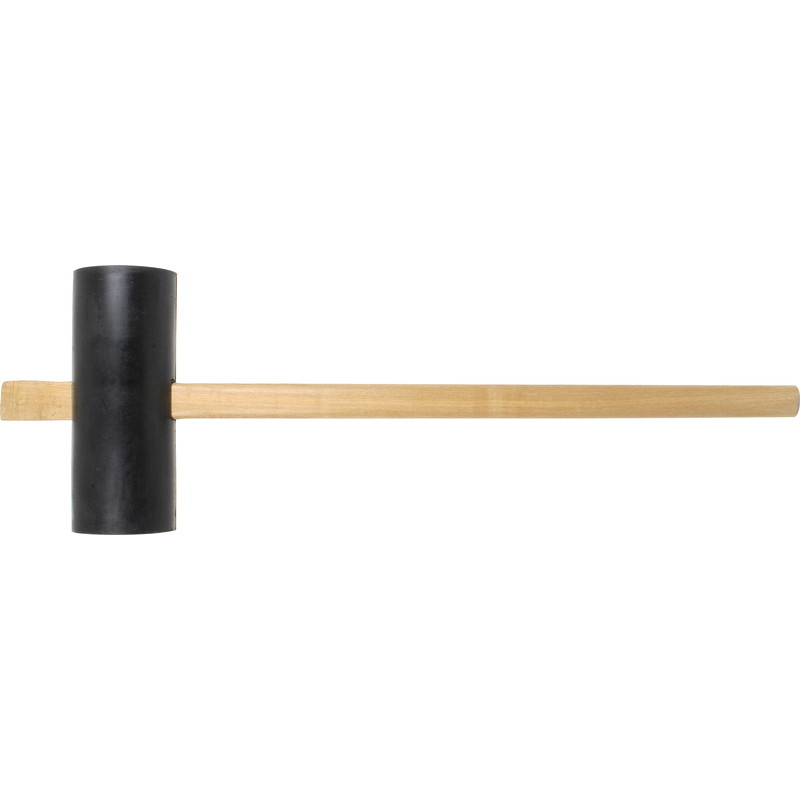

He jacked the van up, tried to remove the wheel and said "That's on there alright" before going back to his van for a padded covering to lay on and a very large leather covered hammer/mallet.
He came back, lay down and whacked it a few times and success!
Spare is on and I'll now sort out repairing or replacing the tyre on the alloy and having all four wheels removed and cooper greased correctly.
Interesting thing was that he said VW's policy is they don't use copper grease. They said it's not required...
