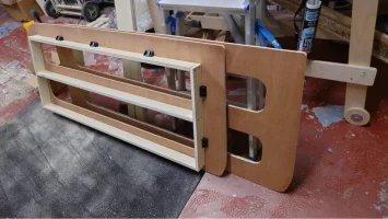

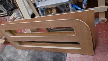

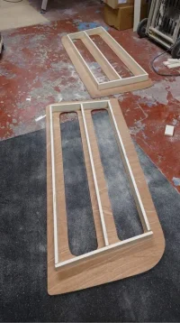

I like the look of that what thickness ply did you use , also how do you fix it to the side of the vanWe have shelves! Just need to drill a hole for some switches, fit the LED lights, attach the backboard, trim them in carpet and make an infill panel for the passenger side!
Pictures of the back if anyone wants to make their own:
View attachment 193089View attachment 193090
Hi Panch, its got L brackets at the bottom and these up at the top Button-fix Type 1 Flush Fix + Lime Green Button for Countersunk Woodscrews 171-018-11 Its made out of 9mm ply, i could have had the shelves wider at the bottom but kept it equal for the moment.I like the look of that what thickness ply did you use , also how do you fix it to the side of the van
Thanks
