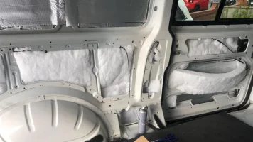

Cleaned the front ready to sound deaden

sorted out some of the insulation

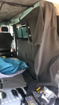

Well we have had a couple of busy days:
Window is a bit messy, waiting on the trim and the vanshades to arrive:
