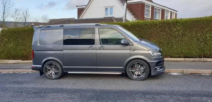

I fixed it, I sold it and bought a T6.
I put this picture on the Mercedes Benz UK Vans Facebook page and said, "Look, I got my paintwork issues sorted"
They actually responded by saying, "good news Brian, your van looks like new again. Glad to hear your local dealer was able to help"!
Now, if this is what expert company representation is from a manufacturer I am not surprised in the level of assistance we receive.
I had to reply, "yes, it's now a Volkswagen" Funnily enough the post was removed very soon after ;):rofl:
