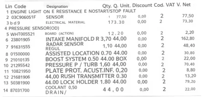

Did this ever get resolved satisfactorily? My 2019 LWB 204 DSG (10,000 Miles - mostly short journeys) has started doing odd things including 'Start Stop Error' on dash, regular glow plug light flashing after a minute or so of starting from cold (no problem starting and no light for first 60+ seconds and no loss of power). Restarting clears the flashing glow plug light and then it doesn't return whilst the engine is warm. Other posts on here suggest it could be due to gumming up/egr problems?
Gumming up egr sounds about right.
I had multiple sensor failures that resulted in the engine running very rich (I think) for a couple of thousand miles, this gummed everything up (see earlier photos) & resulted in a cascade of sensor failures
They had no idea what caused the problem but suspected some very dodgy fuel
They cleaned the heavy carbon build up & replaced all failed sensors & it seems to be fine now.
I’ll attach the repair bill, it was in Portuguese so not 100% on the translation thru the phone app.
I advise you get a proper diagnostic checkup asap on all sensors
