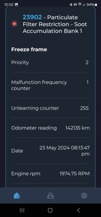

Recently the engine and glow plug light came on. When I checked it one app said,
23902
Volkswagen: P2463 - Particulate Filter Restriction.
and on Carista
23902
Particulate Filter Restriction - Soot accumulation Bank 1
No other fault codes apart from that one, and any time I try to reset the fault code, it just returns immediately.

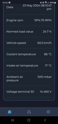

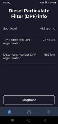

The current soot level is 40g, and going up slowly. It is not in limp mode yet, but I presume this will happen when it hits about 50g? I am trying to limit my driving, but
I am pretty sure it is down to how the vehicle is used, as I only really used to transport my mums mobility scooter on short journeys, as well as trips to the shops. It may occasionally goes for a long drive once every couple of months.
So far I have tried a letting the van regen itself by taking it on a long drive, but that didn't work.
I have also tried to force a parked and driving regen with Carista, OBDeleven and a launch machine. Again, none of these has worked.
