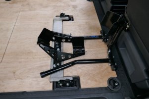

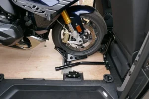

So far I think this setup using original seat brackets is the neatest but probably quite costly just for a 1 off trip. (Page 41)

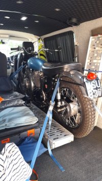

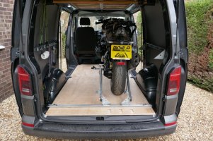

I made a similar set up....8' x 4' sheet of 1" ply bolted to floor through rear lashing points and a couple of old seat feet. Fits and removes in minutes and very secure. I only used the plywood to protect my floor but it isn't strictly necessary.

That's great thanks! I've ordered 2 seat feet to mock something up, but I've 2 bikes I need to move for this trip so I will end up with a foot at either side of the van and quite a stretch between them. I'd say 1 bike behind each chair is where they will line up
Also, thinking I will need to stagger them a bit as with wider adv/enduro bars they might get in the way
Easy with one bike but with two it might take a bit of jiggery pokery to get them to fit. If the enduro bike is smaller than adventure bike the bars might fit one over the top of the other or you might have to fit enduro rear end in first. Might be worth using the seat feet setup to fix the biggest bike in position and then put the smaller one in however it will fit, guess you will find all this out when you try and mock something up. Hopefully you will find a set up that enables you to load/unload quickly and easily without the need for millions of straps/bits of foam/cloth packing etc which becomes very tiresome if loading/unloading frequently, with my one bike setup I have a unistrut clamp that goes through the back wheel, takes seconds to bolt up, no straps, no packing, solid. Oh and by the way mines a SWB Kombi......Good luck :thumbsup:

The 1 bike situation is ideal and 99% what I do most so I think whatever I knock up will be a copy/clone of the 2 setups using the seat feet mod as I am calling it!
2 bike situation, maybe 2 or 3 times a year but absolutely straps I can handle, having to pillows / blankets etc etc between them is a complete bum ache!
I certainly don't want to be drilling holes through the floor and adding L-track etc. I did some of that in my T5 and it was a pig of a job. Then.... I only used it for 1 particular situation in 4 years!
