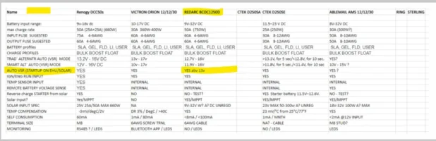

you will find with the engine OFF the Redarc will switch ON when the starter battery feed hits 12.9V
View attachment 183622View attachment 183623
if you get a chance to test it let us know. . . .
@Loz
i just realised I've already tested it,
and the REDARC does have the AUTO VSR feature. . .
I've detailed them on the spreadsheet on page 1:
DC-DC Charger (for Leisure battery) -- How I Done It --

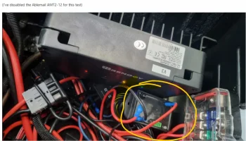

yes . .
i fitted the Ablemail AMT2-12 as its programmable, to get around that very "cycling on/off" problem
so that i can back charge the starter, from the large ROAMER 230Ah . . BUT,
keep the top starter voltage just below the DC-DC Charger trigger ON voltage. ( currently a Renogy DC50s )
it took a few weeks of tweaking to get the voltage levels set for my system. . .
but it fine now and works a treat:
I've detailed it here: [Guide] Battery Maintainer (for Starter battery) -- How I Done It --

Gen2 has spade terminal instead of studs - to better reflect the 4A charger pulses,
this is my Gen2 Amt2-12 - i disabled it for the Portable power pack testing . .
